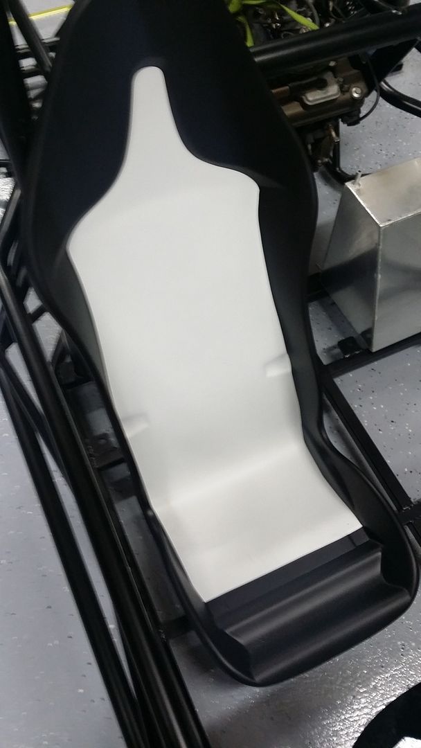

Has anybody purchased these seats with their kits from SVE / RTR? If you have, can you give me an idea of how you mounted them?
Post by kiwicanfly on Sept 27, 2015 7:18:19 GMT
They look a bit flash compared to the usual RTR seats that most buy from RTR.
Were there not mounts and runners in your kit?
Post by OzExoNinja on Sept 27, 2015 8:13:22 GMT
Hmm, not quite everything in the kit unfortunately, but it is a kit car so I will have to figure some things out for myself.
Post by davef on Sept 27, 2015 13:20:30 GMT
With regard to the seat brackets, have a look at my build blog, I fitted the same seats I think. I bent some brackets out of 6mm steel, powder coated the brackets and bolted them to the CBS sliders.
