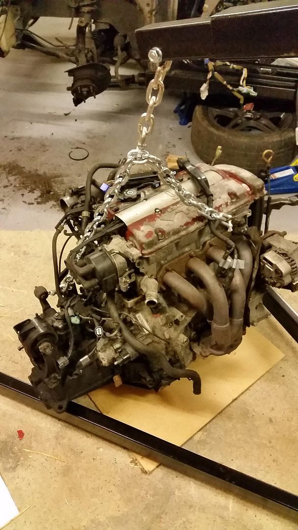

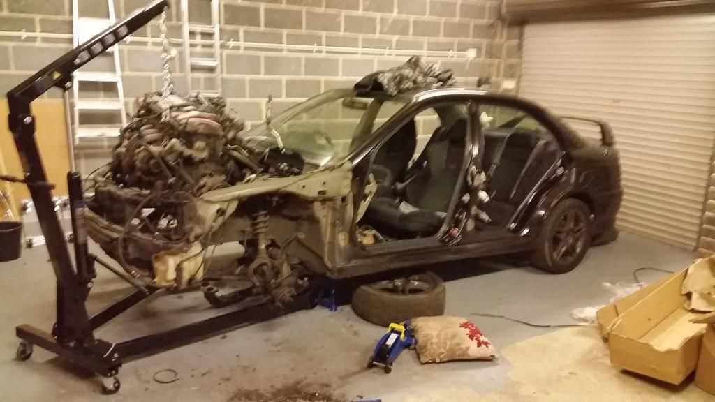

Post by carlyd on Jan 2, 2015 21:56:18 GMT
I managed to remove the engine and gearbox from my Honda Accord Type R. It was a nightmare, god knows how they fit that engine in the factory, it was so tight.

The engine and gearbox will be going to RTR sometime this week hopefully for a custom fit and custom driveshafts. Then off to powder coating. I rekon I'm probably a month or so from getting my kit now.. very excited now !
