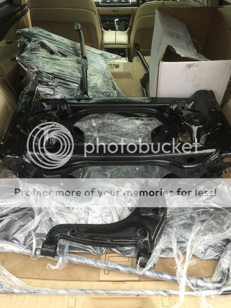

Post by bigpaul on Feb 14, 2016 16:47:56 GMT
Gents, how much movement should there be in the diff bushes? They look ok, but when I put the subframe on and tighten up the nuts the subframe does rock, whilst I would certainly expect to see some movement it seems like quite a bit,
