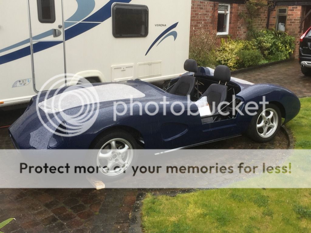

Needed to have a tidy up in the garage, so rested the body on just to make me feel I am further along than I am!
Post by john on Apr 24, 2016 17:37:30 GMT
Ha ha, been tempted myself does look good in blue
Post by bigpaul on Apr 24, 2016 20:31:42 GMT
It was actually worth doing mate, rear brace is miles off, assumed it bolted onto rear mounting bolts but would say that's about 3 inches off, where did you bolt yours to?

Post by bigpaul on Apr 26, 2016 15:51:58 GMT
John, sorry should have been clearer, it was actually about 3 inches too long, front of the arches were rubbing on the wheels
Post by stevednorris on Apr 26, 2016 15:55:30 GMT
I've put slots about 10 cms long in the frame where it bolts to the chassis to allow some adjustment.
Post by marmot0 on Apr 26, 2016 19:00:04 GMT
I fitted my bodywork and then offered up the rear frame. Cheers
Post by bigpaul on Apr 26, 2016 21:30:58 GMT
Thanks gents makes sense, will make the necessary changes once I am ready to mount the body
