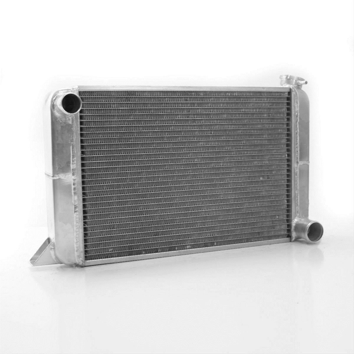

Post by franknbeans on Jan 27, 2016 22:19:12 GMT
Ok, having some radiator issues here in the USA. Lets start with what I have. I picked this up and I am unsure if it would be sufficient enough for the car. My concern is that the inlet and outlets are a bit smaller than I thought they would be. It is 2.5" (6.5cm) thick though, so the thickness may be sufficient enough. Thoughts? I did find a radiator that is similar to the Polo one you guys in Europe are using. Dimensions are Overall Width (in): 17.000 in. (431.8 mm) Overall Height (in): 18.500 in. (470 mm) Overall Thickness (in): 3.000 in. (76 mm) My issue is; how are you guys mounting a radiator this large? When I measure it looks like the bottom of the radiator will stick out the bottom of the nose cone by half a inch (12.7 mm) Are you leaning the radiator forward to not stick out the bottom?
