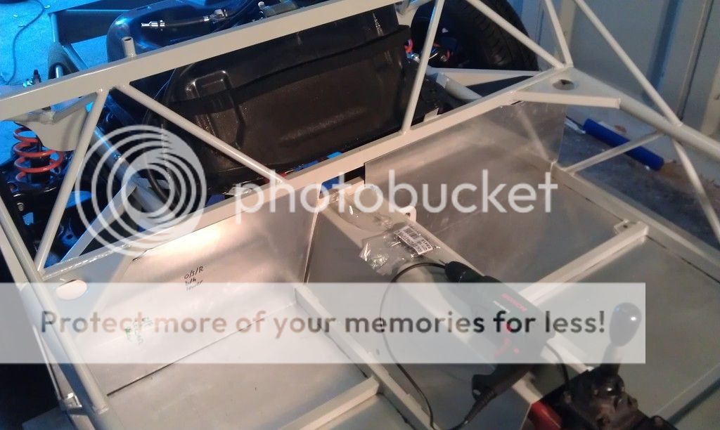

Little update started a few jobs , fitted the rear body support took a bit longer than I thought but that was mostly drilling all the holes out. Took steering column back off to look at tweaking it to get it lined up better going to follow westie tip. Fitted rubber fuel lines on tank and fitted fuel filter need to finish my metal fuel lines though. Trimmed up both lower bulkhead panels not going to fit them until finished fuel lines. Also trimmed up drivers side footwell and passenger side which is 90% done , the passenger side was a pain if I'm honest. Still need to do final fit with the transmission tunnel in place , I've cut out rough gearstick hole in tunnel. Hopefully this week will mock up the tunnel in place so can then do final trim on passenger footwell.

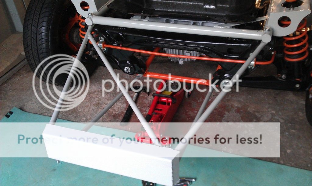

Post by R2S on Feb 15, 2016 17:45:15 GMT
That rear body support did lower arms come with the kit?
Post by john on Feb 15, 2016 19:23:45 GMT
Yes the top bars with the diagonal are fixed welded in. The bottom two bars which attach to the lower subframe needed drilling and bolting at both ends. Looks like a different style than on the previous build threads.
Post by R2S on Feb 15, 2016 22:29:28 GMT
originals only have the top two bars, clearly the additional two will make it stiffer.
Post by stevednorris on Feb 16, 2016 9:53:12 GMT
R2S - I would check with Stewart but I think the originals did have the bottom 2 bars (they didn't have the diagonal brace) as they are certainly show in Stewart's original build blog. I'd hate your rear bodywork to collapse if you haven't got them.
