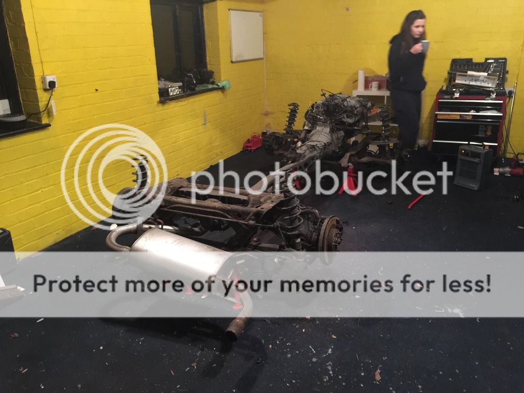

Post by bigpaul on Dec 6, 2015 19:23:50 GMT
Not bad thanks mate, body ready to come off just last couple of bolts to get off, everything else now disconnected, how about yourself?
Post by john on Dec 7, 2015 12:38:14 GMT
Good news sounds like progressing nicely, I'm ready for my chassis if I'm honest I'm just tidying up the subframes and bits and bobs. Noticed some split pins missing from the castle nuts and ordered new banjo brake pipes also I think my droplinks look split despite them looking new.

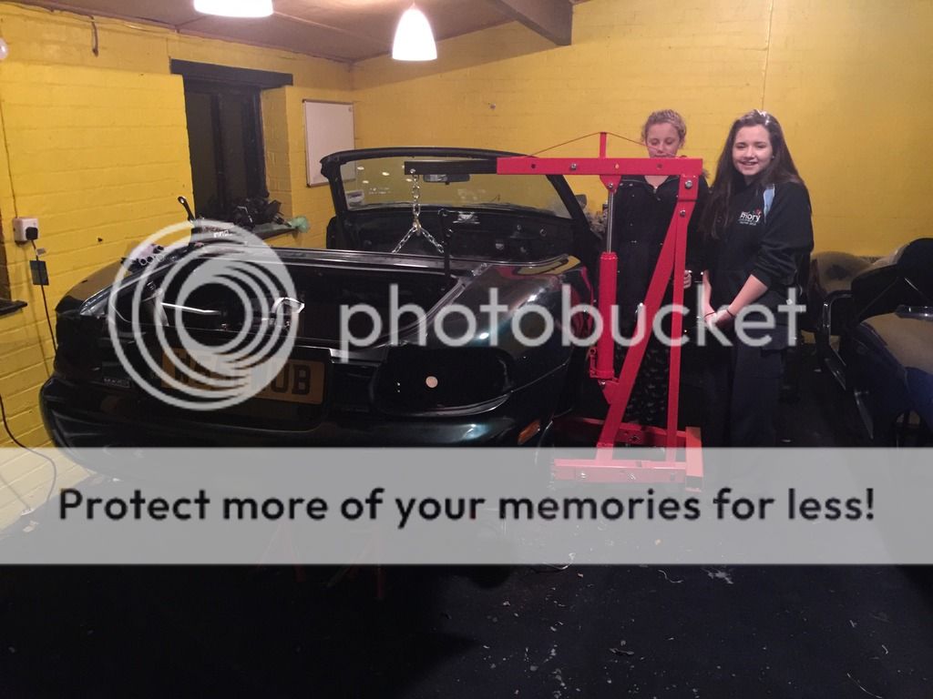

Post by bigpaul on Dec 17, 2015 20:13:39 GMT
Got home early from work today so thought I would enlist a bit of child labour! Now the cleaning, painting and replacing begins!
Post by gwnwar on Dec 17, 2015 21:58:18 GMT
Don't forget to take the shock top hats off the donor..
Post by bigpaul on Dec 17, 2015 22:56:20 GMT
Thanks gwnwar, have put them safely away
