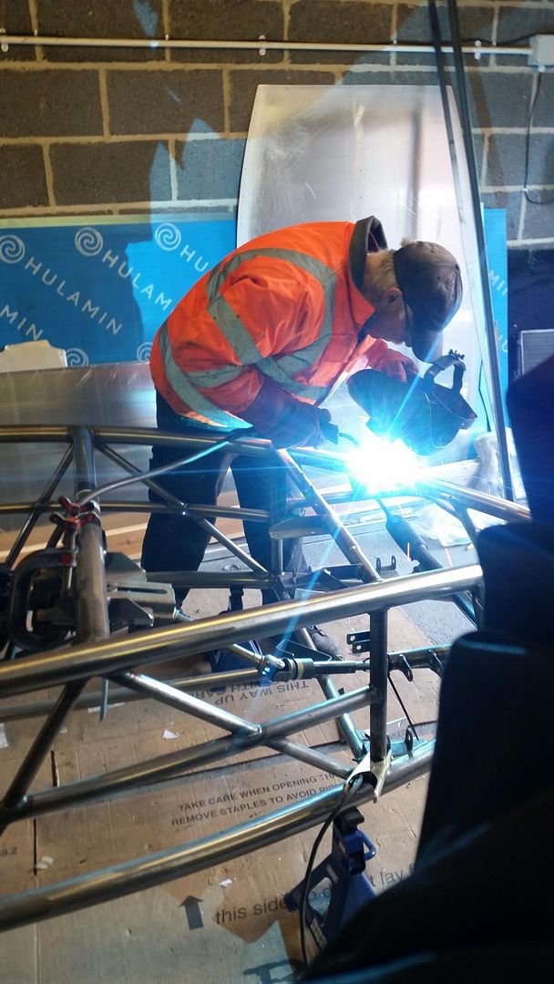

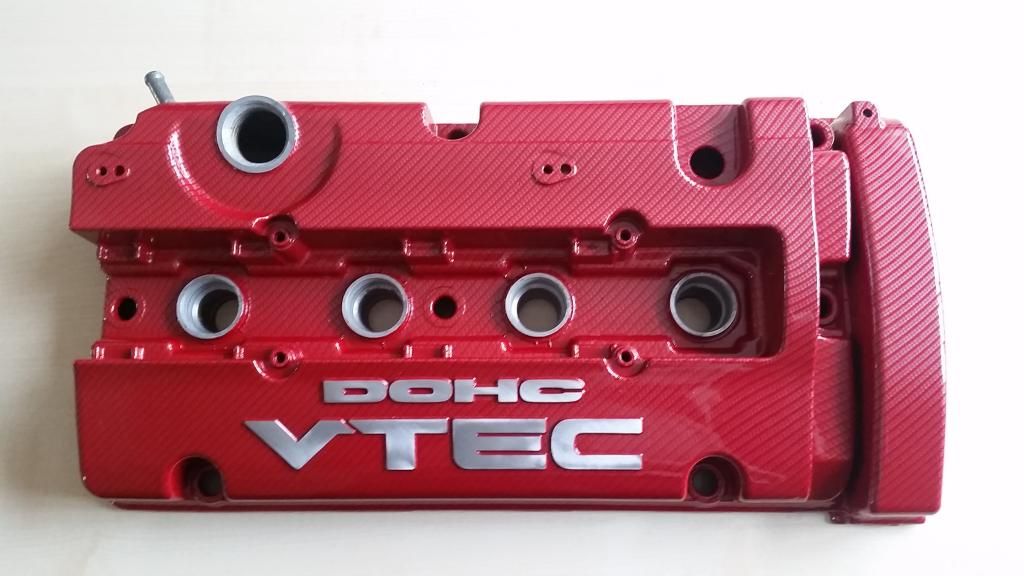

I picked up my engine rocker cover from www.hydroprecision.co.uk today. I asked for Red carbon, I think it looks amazing. I'm just waiting for the black insert which goes in the middle, that will be matt black carbon. I have a mobile welder coming to weld the supports in for the gear selector (I'm going Honda Civic position with it, near the steering wheel). He's also welding the steering column, and a solid steel plate under each seat. I've seen this done on the race chassis (which mine is) so not sure why it wasn't done on mine as standard. This will protect my booty should I run over anything sharp enough to puncture the aluminium floor.

I've been cleaning, painting and preparing parts for my rocket for the past couple of weeks. I've also had the welder in to weld my gear selector in place, (Iv'e gone for the Honda Civic Type R gear lever placement) and add some perforated steel sheet under the seats (to protect the occupants ass in case I run a sharp object over. I've had a plate welded in for the Joker pedal and the bearing to support the steering column.
