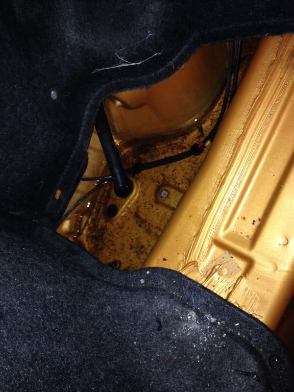

Well since I last posted I've not made a terrific amount of progress. Work, socialising and sorting out the new house have taken priority. I have managed to strip down the boot and rear wings etc. I did have one little surprise waiting for me in the boot. A nice little collection of water in the boot... Seems like a relatively common problem when checking out the forums. It didn't become apparent until I unscrewed the cubby in the boot. Worth noting if your currently looking for a donor. May assist in knocking down the price. Also adding items to eBay takes far longer than anticipated. Oh and a head torch was an inspired purchase if your working in a small garage. Well worth the money. Back in the garage this weekend to crack on....
