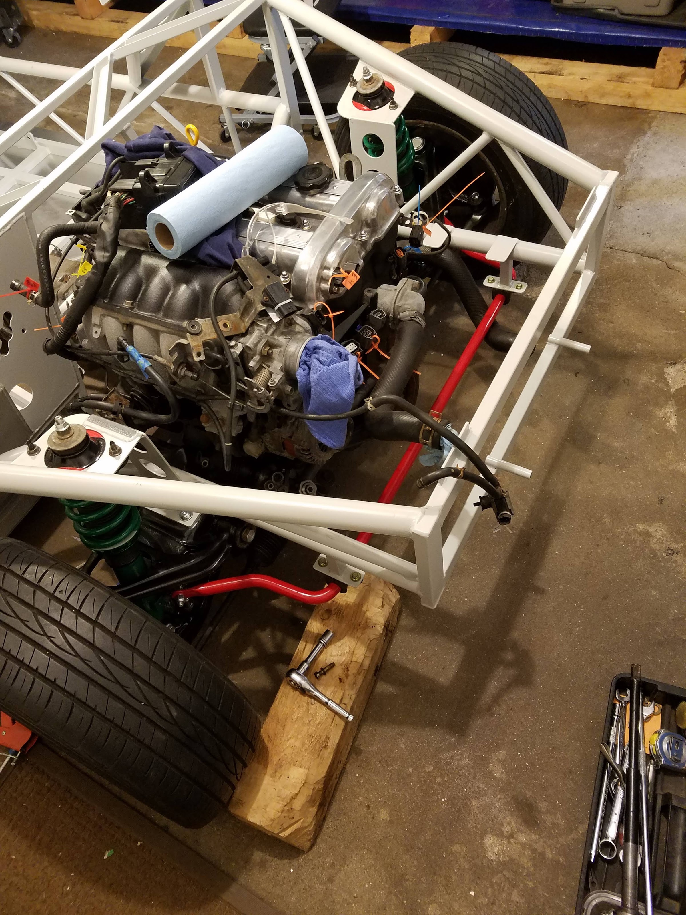

Nothing all that interesting but the front sway bar is in with some adjustable end links. The OEM NB end link length (bolt to bolt) is 4.25" for those that end up buying adjustable end links and need a reference. I've learned that the aim should be to get the sway bar horizontal and 4.25 does the trick in this instance.

Quick note for anyone else doing a LHD to RHD conversion. First of all, you'll need a RHD subframe and steering rack to get the big bits to fit. (done) You'll also need to do a couple of extra modifications. The brake booster feeds off the intake and with that being moved to the right hand side you won't need the big connecting hardline (the big ugly line hiding left). The proportioning valve will also need to be moved either vertically or over to the other side since it will interfere with the frame.

The proportioning valve sits inboard of the master cylinder on RHD cars (as in pic.) So you may have to make up new hard lines to link the two.

Yup, my bracket doesn't have the 90º bend in it but that's fine and new hardlines is something I should do anyway. I've also realized that my throttle cable is now much too long. Anyone have a spare if not I will either have to source a RHD cable or make do with mine in some way.
