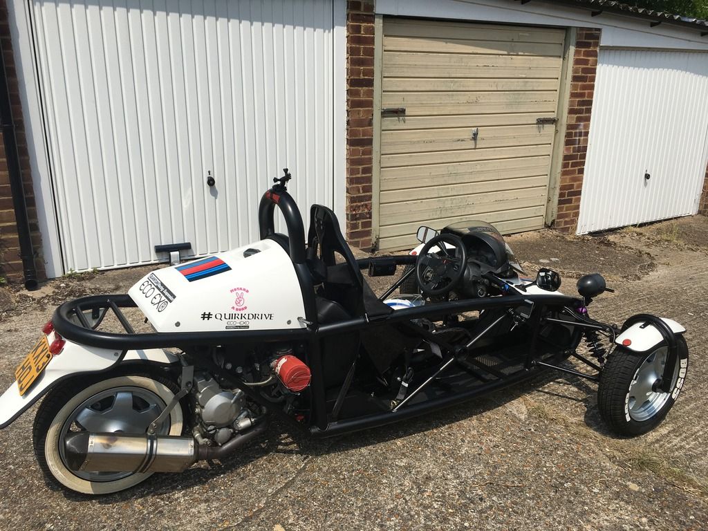

Post by birubhai on Jun 20, 2017 6:49:06 GMT
Whitewall tire, side profile
Post by davej98002 on Jun 20, 2017 17:07:57 GMT
Thanks, ED. Topped up oil and reset tire pressure. Running 30 back as with hard shock setting ride is flat. I added an engine additive last summer that resulted into oil coming out of breather hose possibly due to over filling oil. So topped up just enough to keep levels in check. Hopefully.... Best Babr Babr, one of the many oil topics over on BurgmanUSA has been on oil consumption. The Burgman 400 has been known to use a lot of oil when run hard at high RPM's. So a few owners have tried to overfill them when starting out for a day long ride, only to find oil being blown out the breather hose. Too many worry about keeping it at the top of the full line. As long as it is not below the low level it is fine. I'd say that at gas up time, check the oil level every time and top off to the full level. What oil are you using, name brand and grade? I recommend that if doing a lot of high speed riding to use a 15W40 Jaso-MA rated oil like Shell Rotella T5. A 10W40 may burn faster. Some have gone to 20W50 but in Winter time I'd not recommend that. The Burgman 400 does NOT have a wet clutch so just about any oil will work, unlike the engines used in the tR1ke's 1000cc R1 that does have a wet clutch.
