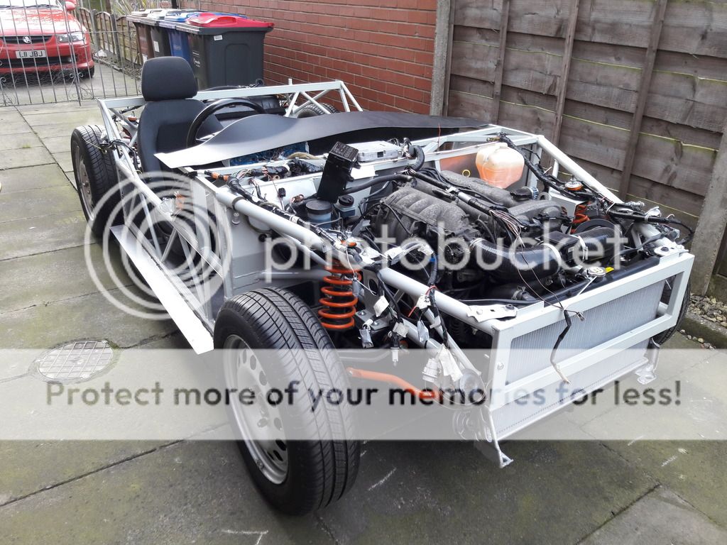

Post by john on Feb 3, 2017 15:52:45 GMT
Just two pics while it was running. See how big the rear back box is.
