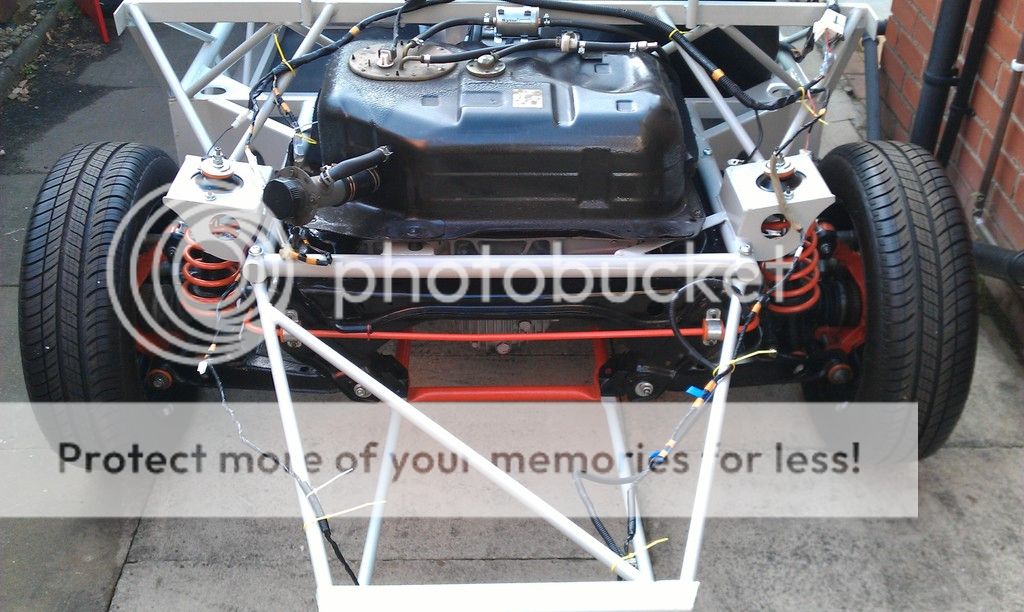

Throttle cable adjusted and it now starts and idles , admittedly it idles a bit high but that's for another day. Bigger issue was a fuel pipe split thankfully I was looking around the fuel system at the time so turned it off quickly. Had to remove the rear fuel lines and tank and order some more. Mystery why as it's the proper stuff or so was advertised.

The other end of hose in pic looks like it has a lite cut in it.. Better check all your hose.. How old is it.. if new bought take it back were you got it ask the WTF.. At least it wasn't on a rood trip or track..

Brand new and not the cheap stuff either, it's just one joint so maybe I've damaged the internal integrity maybe when fitting but at least happened on the test startup and was safe.

Picking up gwnwar's point the pipe at the bottom in your picture (on the edge of the shot) does indeed look like it has a split.
Not sure how you'd damage the internal integrity when fitting (you'd need to do something pretty dramatic), if you purchased from a reputable supplier I'd take it back mate, explain what happened and see what they are prepared to do.

Was the blow out on the tank fitting or a copper line.. If copper did you put a small flare on the end. If so it should be a double flare so no sharp edge to cut inside hose..
