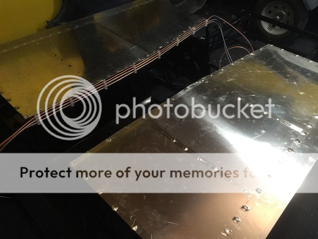

Post by bigpaul on Mar 29, 2016 19:41:29 GMT
Evening all apologies for the lack of updates, ridiculously busy at work the last month or two which has meant the car has fallen down the priority list, but managed to get a bit done over the weekend so thought I best put on the compulsory photo, floor on and fuel/brake line installed
Post by john on Mar 29, 2016 23:15:44 GMT
Nice job mate wish I had clipped mine in while upside down for some reason I fitted the clips and then fitted chassis to running gear.

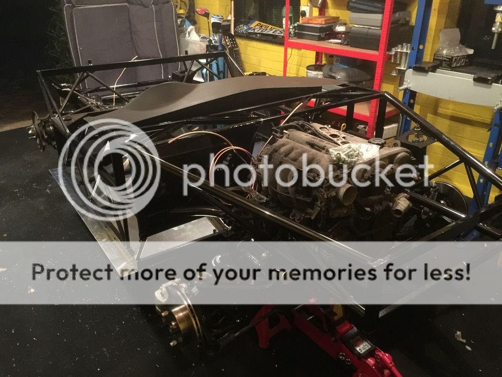

Post by bigpaul on Apr 2, 2016 19:35:19 GMT
Small steps, was miles off line when I put it on, then realised the front subframe was lifting at the back where I had axle stands on it, jacked up front and corner bolts now in
Post by john on Apr 2, 2016 22:38:35 GMT
Big step I see some nice shiney bits.
Post by john on Apr 2, 2016 23:36:24 GMT
I also see golf clubs, guitars and a sofa couch get that stuff in the loft. Garages are for cars ;-)
