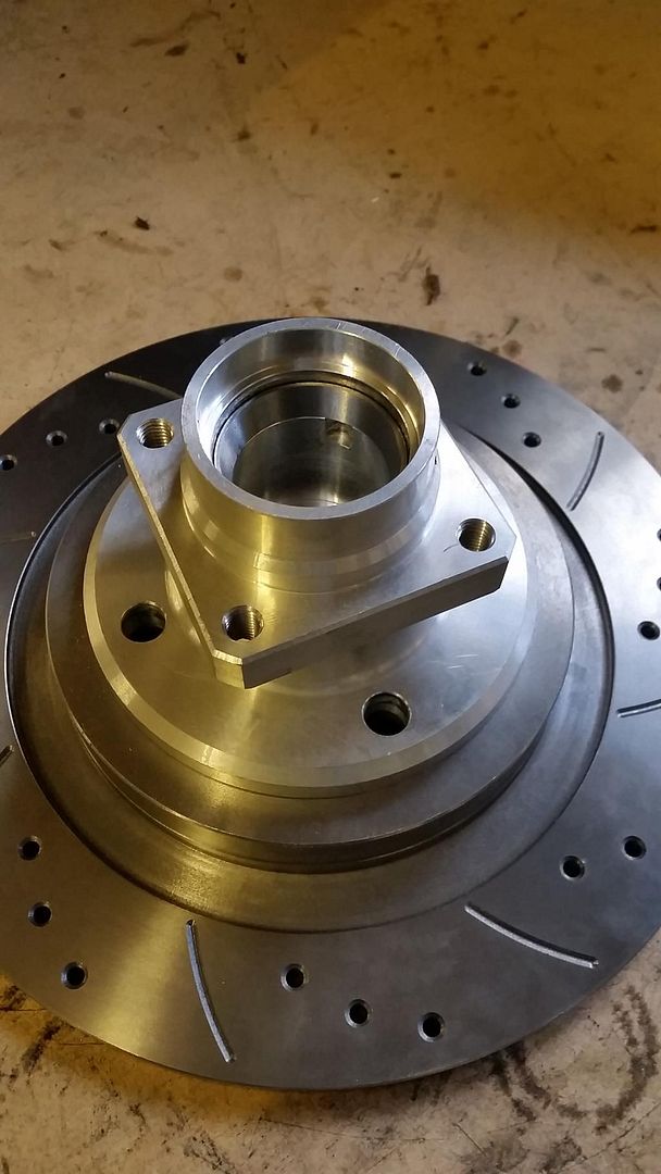

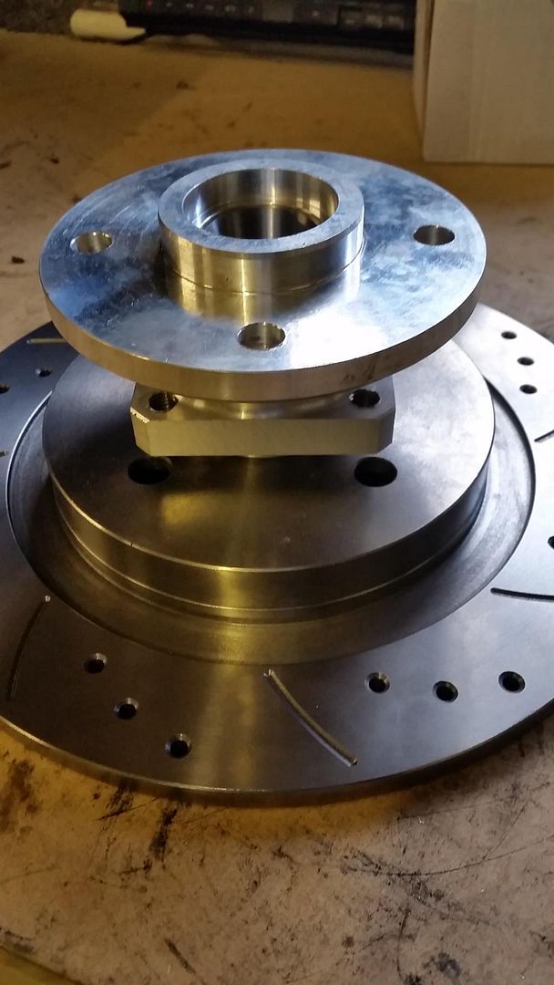

I was mocking up my front suspension today and either I'm stupid or I have some bits missing or different parts. As the front hub assembly comes with literally no instructions and the build CD has two pictures of it all built up with no detail I was looking at Jack and Dads build for reference. I notice their picture ha the front brake disk bolted to the big alloy part (sorry I don't know what it's called) via the square bit that has threads in it, while my disks holes seem to be spaced for the wheel studs? so the threaded square bit does not match the holes in my disks, so this looks different to me (see pic below) Am I going crazy or is something wrong here?? Any help is greatly appreciated. Oh also with the springs I have 185's and 300lbs, which go on front and which go on the rear please? Thanks Carl

The discs your trying to fit onto the alloy hubs are not the correct ones.
The discs you have, are the Focus ST discs by any chance, ford discs have a PCD of 4x108, this is the distance between the bolt holes. As you have probably noticed the disc will fit onto the other side of the hub (Front) as this is were discs normally fit then the wheel goes on. But with these alloy kits, they are designed for old cortina fitment so the disc goes on the rear of the hub and needs a PCD of 4x92 Discs with this fitment can be bought from Rally Design and cost about £90 a pair +vat and postage.
It's a bit of a pain as it means different discs on the front and rear I have exactly the same problems and without any real instructions it took a while for me to get my head round it.
The discs you need to fit on the rear are normal Focus MK1 rear discs (I believe ST ones can be used) and you now need discs from rally design (www,rallydesign.co.uk) for the front it's best to give them a call and state to them what you need.
Hope this helps.

How many sets of discs did RTR send you. If they only sent the ones in the pictures then they are for the rear brakes if they sent you 2 sets of these then I would call them as the discs you have only fit their manufactured uprights not the alloy Rally Design ones.
Post by carlyd on Jan 25, 2015 19:09:13 GMT
I wanted drilled and grooved disks on the front as I intend to do a lot of track days etc. Is it possible that I have been supplied drilled and grooved rear disks and was trying to fit the rear disks to the front? The other set of disks I have are solid and not grooved or drilled and a lot smaller so I presumed they were for the rears, although I haven't checked them yet. Looking at my order form I'm not sure which is which now so I'm going to give Paul at RTR a call tomorrow.

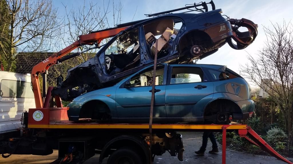

Thanks for the quick response though guys On the upside I had my donor cars removed over the weekend. Believe it or not the guy actually drove off like that.
