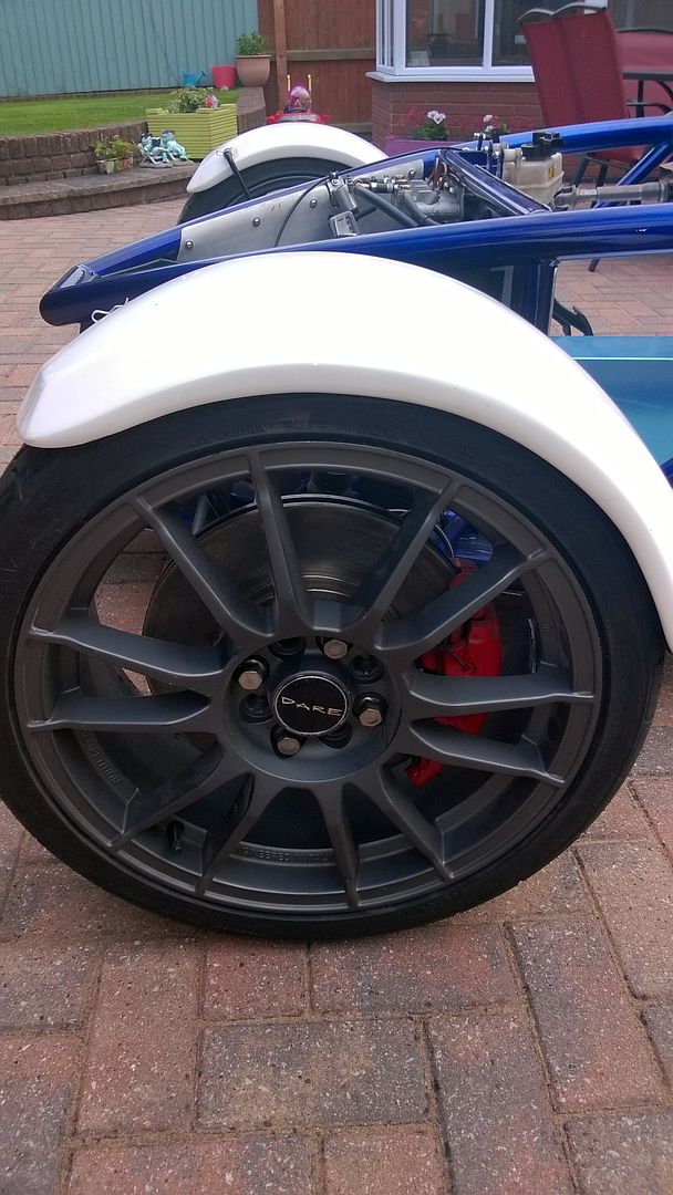

I was still undecided about the way to go with front brakes as I wanted to use vented discs on the front. I know the norm is to go with solid but I though it would be an interesting exercise to see if I could get vented to fit with stock hubs.
After a good bit of searching on fleabag I came up with this. The front disc from a Mondeo ST24.
Its a tight fit but nothing clashes.
I'm just in the process of fitting MK2 Focus calipers. I'll post some pics for anyone interested when they're on. Should be next week some time all being well.
