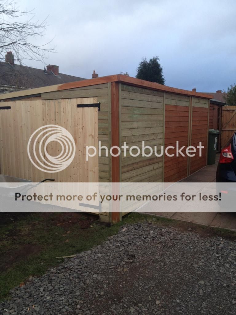

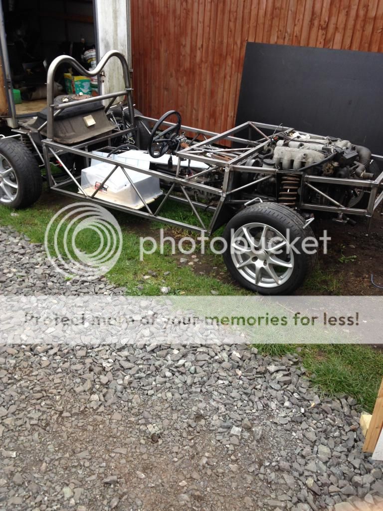

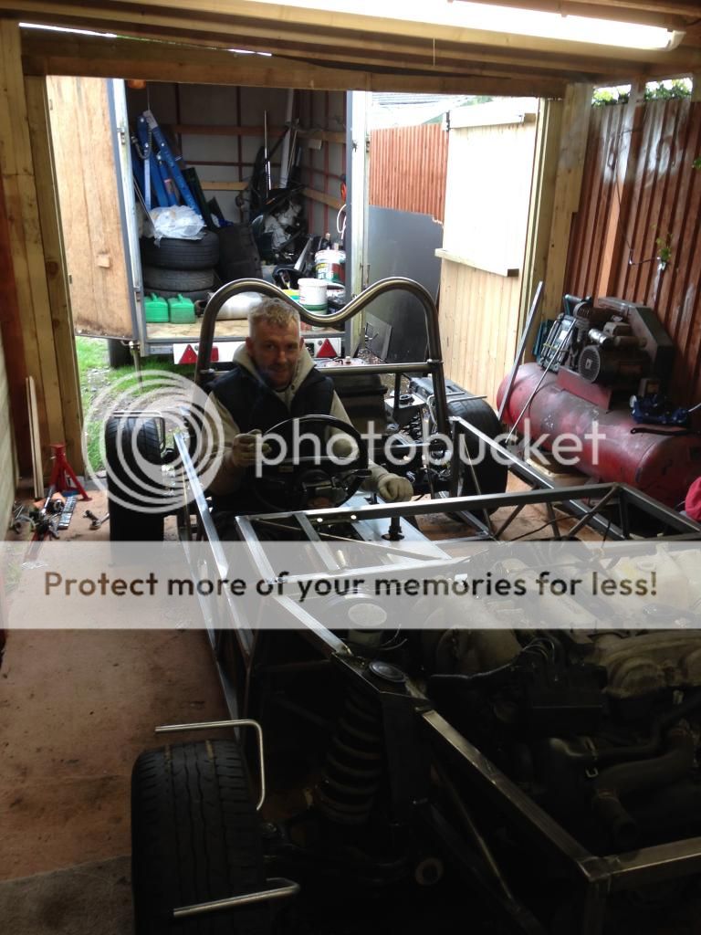

Post by p5curly on Feb 23, 2014 22:34:01 GMT
thought I would post some pics of our build so far firstly the home we made for our new project
then the lift and lastly the running gear in its new home
