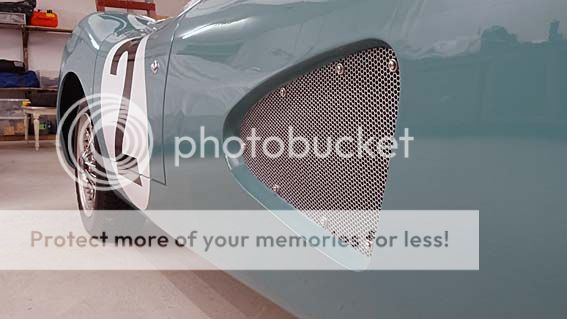

Side Grille in place and graphics applied.

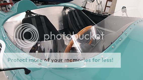

A session with plenty of abrasives and polishing compound gets the edge of the screen lovely and smooth on the edges with a nice radius.

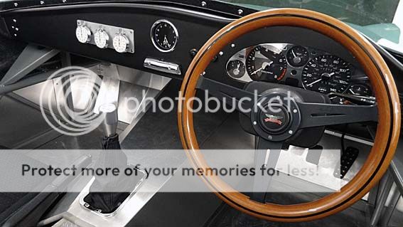

Steering wheel badge made out of a Le Mans Winner lapel badge.
Post by James on Mar 25, 2015 9:06:55 GMT
Smiths wind up clock (perfect 8 day time) off Ebay. Triple stop watch rally timer and interior light.
Post by James on Mar 25, 2015 9:08:21 GMT
They're Russian actually, but they're fun.
