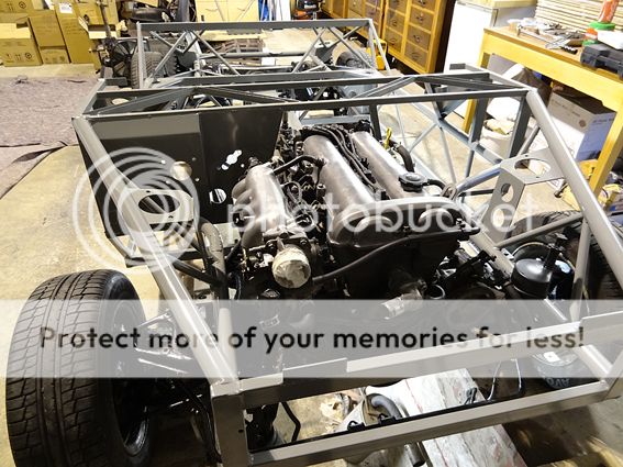

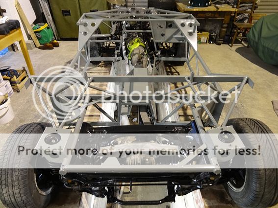

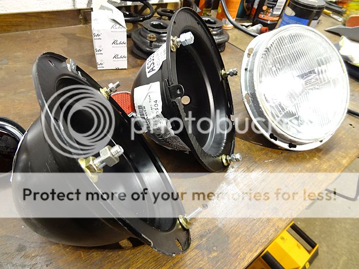

Ah haaah! We're back in action! Thanks everyone for your help with the forum. Sorry I got ratty. Thanks too to 'retired 2 soon' who's hoping to set up the Replicar general chat thread. Right... Quick pic above just to show you two relatively cheap headlamp bowls that Larry found on the Interweb. Still fiddling with adjustable mounting bolts but should be OK. Bowls might be fixed permanently and sprayed in with the final body colour post-IVA. First time offering-up of the space frame. What a satisfying moment! I have to say the frame seems perfect. We expected it to fit, of course, but it was just feels good when all the bolt holes, shocks etc. line up and drop into place. Hats off to Stuart and an excellent jig! Excellent idea to have the frame in the grey and we continually celebrate the powder coating. Such a pleasure to handle and such good value. Front shocks still haven't turned up you'll notice. Looks like a 'Mad Max' vehicle or something military. Certainly feels like we're progressing. Frame whipped off and flipped for flooring. Stuart recommends a 75mm overhang on the 'sills' so some carefull measuring was called for to line up the cross members etc. - all very straightforward really. I drilled the rivets and Larry popped them in and we had it done in no time. So quickly, in fact, that we were nearly finished when we realised we'd forgotten to do something. We had discussed applying a bead of silicone seal around all the frames before dropping the floor pan onto it and rivetting it down. Still a good idea I think. We kicked ourselves but weren't about to drill out all we had done so far. We'll come up with something because we don't like the idea of water being trapped between the alluminium and the steel frame. We used 100-120 mm centres on the rivets - probably overkill as it used about 100 in all. Still, why stop when you're having fun.
