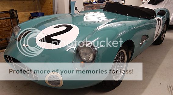

Much more useable with the tonneau. Took her to Harrogate MG annual meeting - literally thousands of cars - it was immediately grabbed at the gate and taken to the paddock for 'cars of special interest'. It was crowded out with spectators all day. It was almost embarrassing. On the road, even motorbikes nod and give you the thumbs up as you as they scream past
Post by R2S on Oct 8, 2015 7:14:32 GMT
Stunning work, particularly the tonneau, keep the pictures coming.
