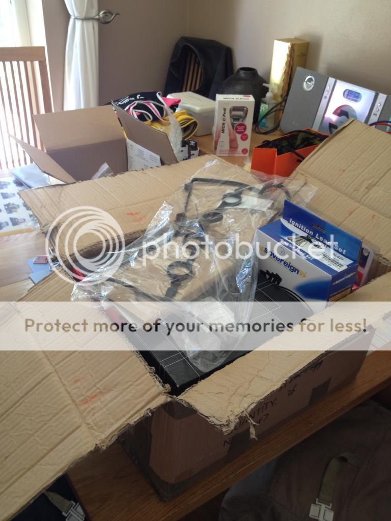

10/06/2014 - More new bits & oil leaksMixed bag today - on thlinke plus side, I got some new bits: and one old bit (can anyone guess what it is?): On the downside - I'm torn on my oil leak situation. I know the CAS needed doing, so I've got everything to do that at the same time as doign the timing (and water pump); but I'm not 100% convinced that's the problem, having stripped it. it looks like I could have two other issues - see these threads: muck on the back of one intake valve = stem seal?Oil leak assistance please I want to do this right first time, so I'm inclined to do preventative management by default; but on the other hand, if I go much further down this route I'm not far short of doing a rebuild and might as well commit. Thoughts/answers on a postcard?

Looks like between the CAS O ring and the cam cover gasket should fix the oil leaks on the back of engine..Remember to put some sealant at the corners of the cam towers front and rear to help seal the gasket..Intake and exhaust gaskets will seal the sides.. If you are going to freshen the head now is time to do. If you have the cash now..Or finish your build and do work if/when it really starts blowing smoke. Check with machine shops for cost to surface, pressure check and do valve job.. As for a total rebuild I would hold off you said engine was running fine.. Good advice as always The plan has always been to get it up and running first and then look at supercharging.... so I'll hold off. What goodies you got mate Gear for a full service (the usual) plus timing belt, CAS 'o' ring, intake/exhaust gaskets.... The big black box however is a bit special - it's a manual rack. I've already begun the process of depowering the PAS rack that I had in the car but since then I've a big of digging into it. If you want to go for a full depower it seems you really need to do some welding due to how the PAS system actually works. More info Here: forum.miata.net/vb/showthread.php?t=335874So for now I'm going to run with a fully manual rack - and if I'm underwhelmed, I still have the option to return to my depowered PAS and get it welded. If not, I'll sell it on. Win-win.

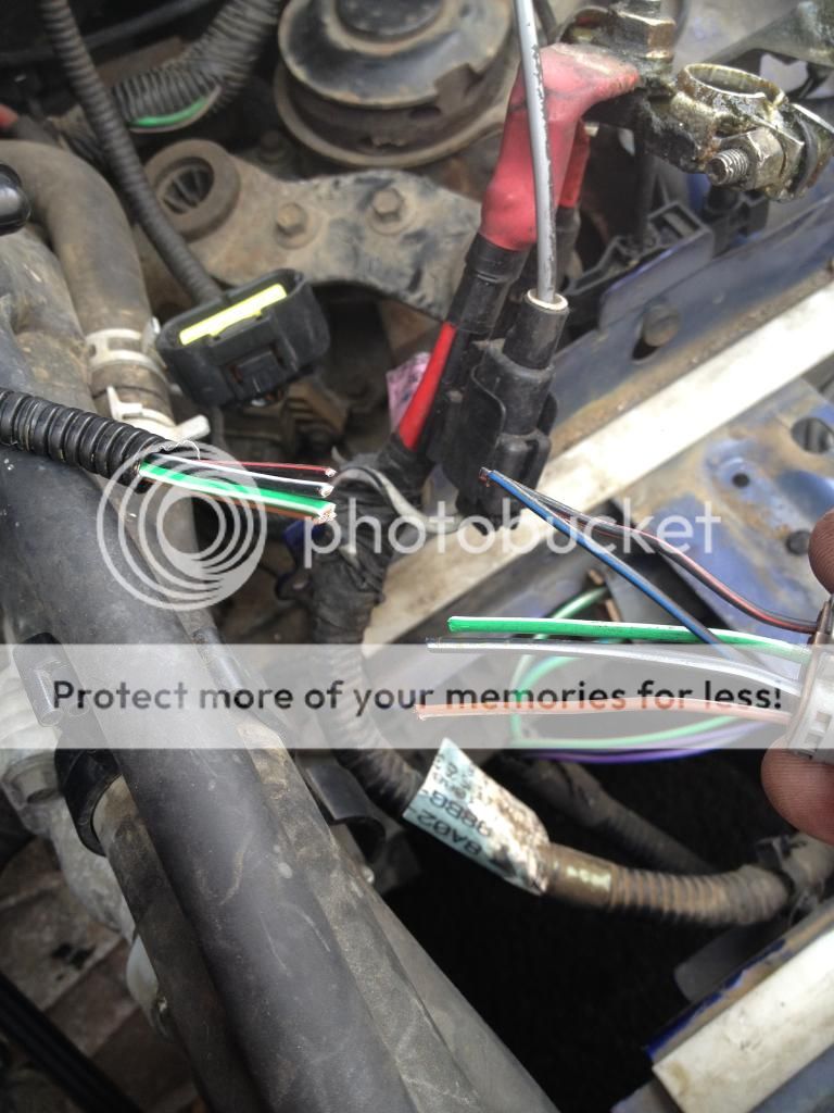

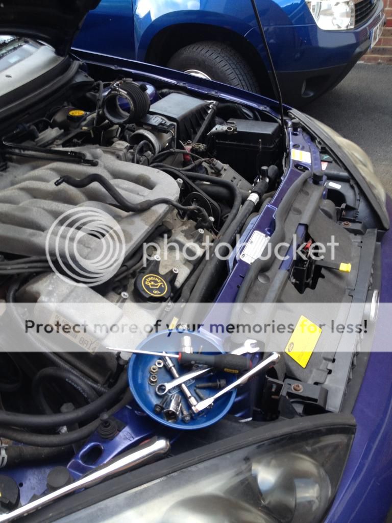

14/06/2014 - Fun with the CougarNot a Mevster update this one - but an example of how I get dragged into things that keep me off the kit project. Take today - as some of you may be aware, the Ford V6 fitted in the Cougar (as well as the Mondeo) has a known weakness in the location of the IMRC.... on the front, right about the exhaust headers. Transistor in the IMRC uses the lower edge of the casing as a heatsink, but this is being baked by the exhaust... end result, one fried IMRC and no lovely dollop of extra go above 3.5K RPM. There are fixes for the fault; replacing the IMRC as a whole, desoldering the Transistor and fitting a new one etc but they don't solve the cause. So some people have taken to relocating it elsewhere. Generally speaking, within the limits of the existing loom, the best you can do is the trailing edge of the battery tray hanging by one edge only. I thought I could do a little better I've spent the afternoon cutting and extending the loom (in hindsight, probably not the best idea to do on your daily driver without a backup plan!) and creating a cradle to hold the IMRC in place under the tray using all 3 mounting points. it normally sits on the free unoccupied posts (under a plastic cover): SNIP! In it's new home ,under the battery tray - and with the loom extended by a strip, solder, shrink wrap, and then bundle wrap (inc silicon tape at the two joints)

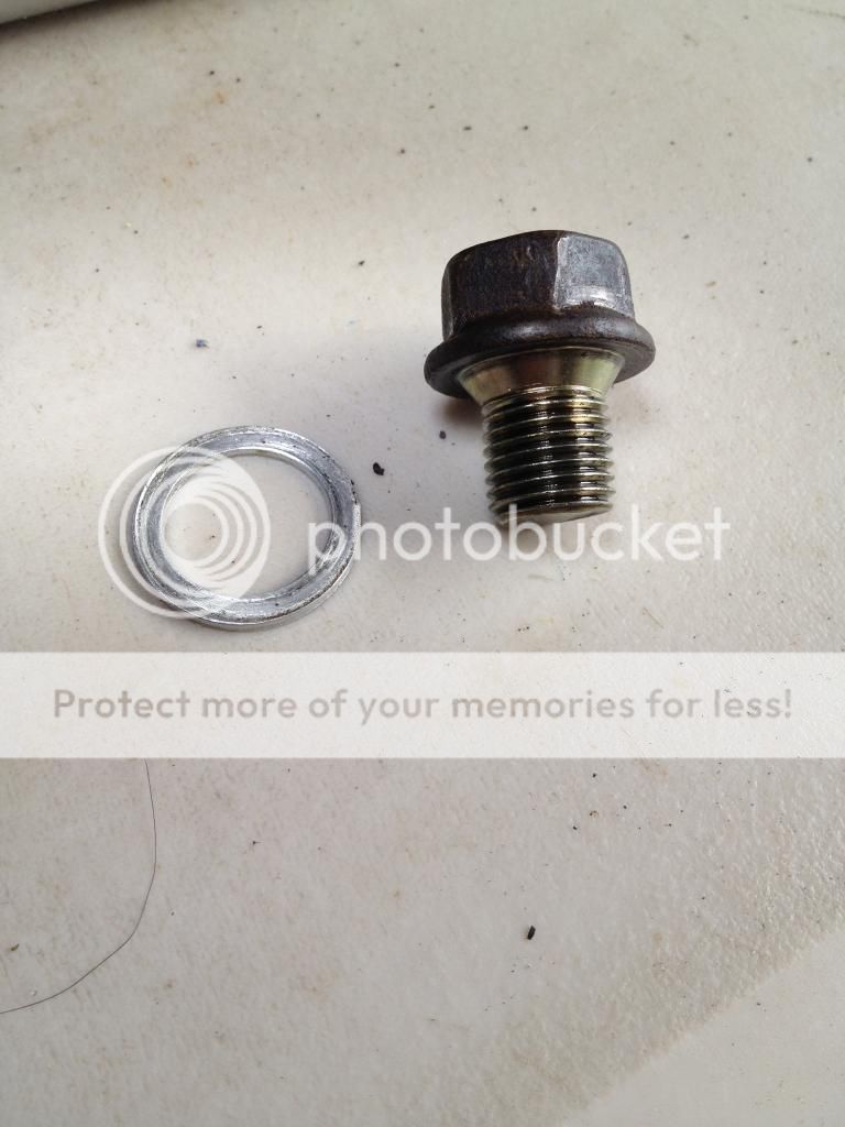

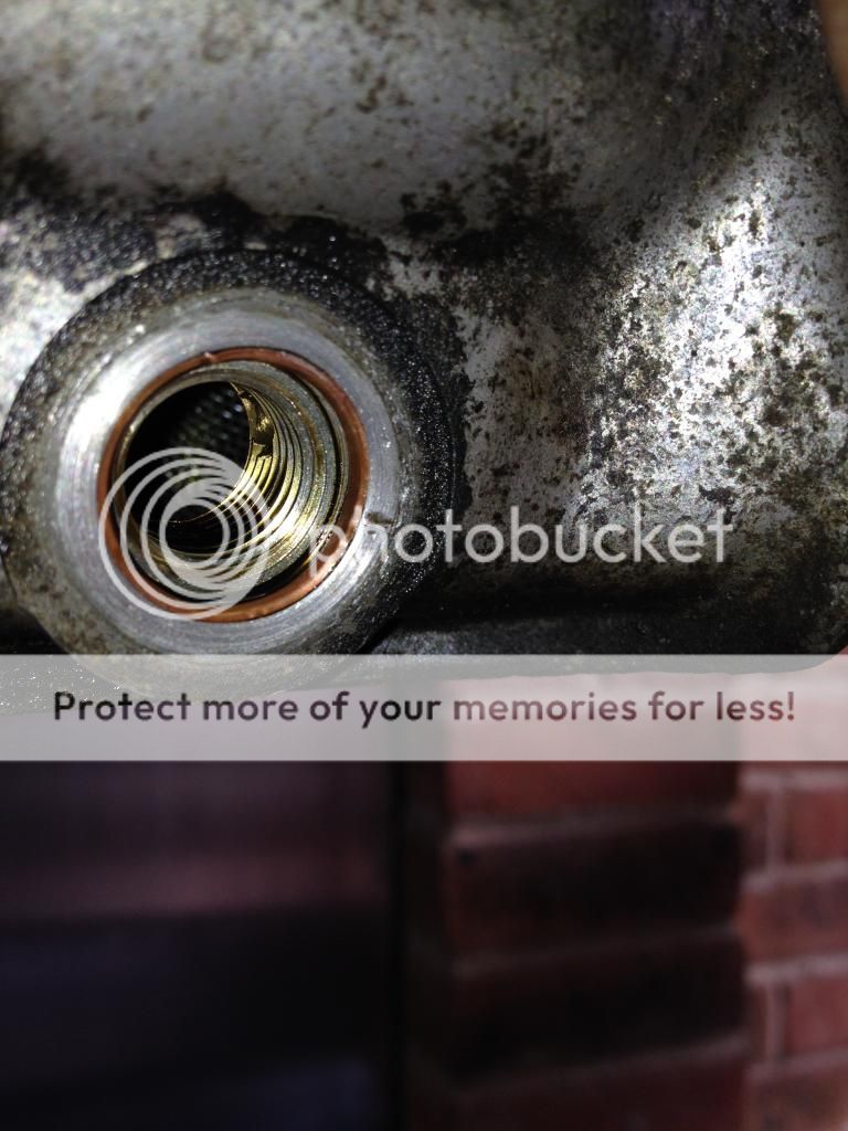

29/06/2014 - Helicoil in Sump and a copper ring... normal?I drained the sump and put the original bolt back hand-tight only a while ago... I have to admit I wasn't paying a huge amount of attention to it then as it looked fairly standard. Anyway - revisited today as I noticed some oil under the engine after fettling yesterday (re-sealing some of the holes with heatshield tape, following the idea others have used). Assumed the bolt had somehow worked it's way loose and just needed a small nip-up. Then I took a closer look. The bolt and washer seem standard enough: But the thread itself less so - looks to have been helicoiled (I've no personal experience with the things, but I can see the holes at the side used to drive this in... I think this is more correctly called a self-tapping insert because it appears to be solid?) Anyway... my question - you can see there is a copper sealing face just inside the plughole face.... it's mostly flush, but some areas are recessed and some slightly proud. 1) Is this standard? Or added as part of the insert? (first MX-5 so no frame of reference; have checked hyanes and workshop manuals, google etc and can't find a mention one way or the other). 2) In either case, any ideas how critical it is to the seal? (I'm thinking of very carefully reducing the proud area to flush if it does, sod all idea what to be with the recessed part). 3) You can see a notch at approx 4 o'clock.... it's not all that deep (the picture makes it look worse than it is) but my gut feel is the ali washer won't seal properly. In all honesty, I didn't notice a leak from this area before dismantling... it's odd because it is very precise (very defined edge) and doesn't exceed the washer 'ring' in either direction. It looks almost deliberate. Again, any ideas? As best as I could tell, the helicoil is in at the right angle (despite 1 showing some uneveness on the copper). So I'm inclined not to sweat it a huge deal.... possibly put a smear of RTV sealant on-top/behind the washer?
