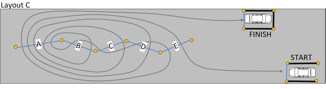

I roughed out three layouts, one forward only.

Layout C.
Forward only.
Rockets, Sonic,s Exocets , BECs and trikes
• Orange bollards must not be touched. (1 fault for each touch)
• No crossing Thick black solid Lines, (3 faults)
• Vehicles must proceed though tests in the following order in a forward motion. This is taken to mean at least one forward wheel first across each line.
E,A,D,A,C,A,B,A,B,C,D,E,A,FINISH ( 1 fault for each sequence mistake )
Layout Notes
Garages will be laid out so that they are 20cm wider than the widest vehicle and 40 cm longer than the longest vehicle. This will make them quite tight.
Generally bollards will be spaced no less than 2.5 meters apart but if there is space this might be extended to 4 meters.
• In layout C, Line A is 6 meters long to encourage drifted corners on that one.
The winner is the person with the fewest faults, If two or more people have the same number of faults then the winner is the person who in the management's sole discretion displayed the most flair and provided the best entertainment.
These are just some thoughts to get the discussion going. The location looks great.
All ideas are welcome.
